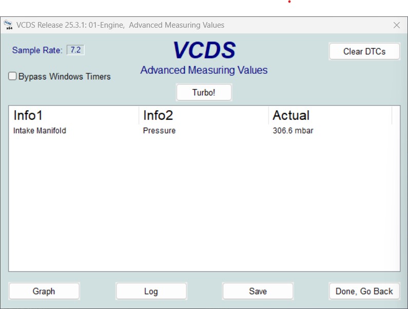

I will check vacuum at the pump during idle this weekend. Good point!

306mBar
