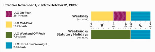

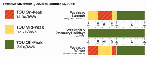

Well, according to my limited research, I could potentially get into even cheaper charging rates.... I'd have to look at my current utility usage to see if it would make sense to switch to a different cost scheme from my utility provider. (currently on TOU but option to go ULO is there)
But even then, I still need to consider the cost of a home charger and installation, which around here would probably run me ~$2k in upfront cost.
