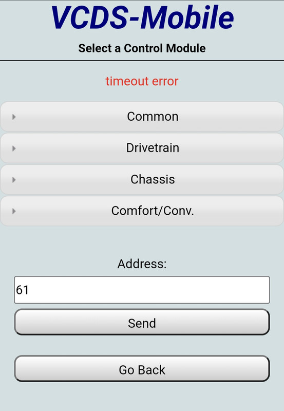

I've done an autoscan and then when I go to clear codes I can't access certain addresses.. It just times out. Anyone have any ideas why?

It's an A6 allroad and I can't access the engine address or the air suspension electrics etc.. Managed to access abs and clear faults but a few just time out..

2015 - A6 Allroad 3ltr..
The autoscan is fine, I've included photos of the time out error I get when accessing certain addresses..

I get timeout when trying to access individual addresses..
Eric
4,902
7,599
HC800000
Help me out here. Your screenshots show timeouts on addresses 61, 45 and 4B, which are clearly absent from the autoscan you finally posted. Are you really trying to access control modules that don't exist in your car and wondering why they're timing out?
F4llenAng3l
Mar 15, 2025
7
C?ID=597475
I forgot to screenshot when it wasn't allowing me I to the engine Address.. it was timing out on address 46 as well..
Eric
4,902
7,599
HC800000
OK now we finally may have the issue described correctly :-) One last thing to try, connect a battery charger or start the engine assuming that poor battery is still able. Your voltage at 11.2V may be too low for a reliable connection.
F4llenAng3l
Mar 15, 2025
7
C?ID=597475
It's a brand new battery but may be low as I haven't given it a run out yet, need to change the broken level sensor tomorrow.. 🙈
You should have seen all the error codes before I changed it! It had gone into energy management mode and shut down many functions.. 🙈
Thank you for your help.. 😊
