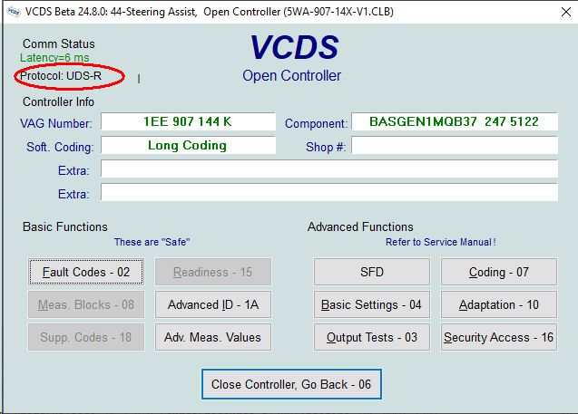

We would need an ENG version of VCDS, which you can download here and which will work without problems, along with your original version.
Further, with SFD modules it usually looks like this (VCID: 5AE6FFAACCEA2E1A71F-810E SFD):
Adres 15: Airbag (J234)       Plik etykiet:. 8W0-959-655.clb
   Oznaczenie elementu SW: 8W0 959 655 T    HW: 8W0 959 655 T
   Komponent: AirbagVW34    H07 1834
   Numer seryjny: 0038FM005MMB Numer zestawu danych: 8W0909602DA 0016
   Kodowanie: BFCCF0C000A00000A000003FF20C400000C5
   Kod serwisu: WSC 06335 790 00001
   Zbi�r danych ASAM: EV_AirbaVW31SMEAU65x 003003
   ROD: EV_AirbaVW31SMEAU65x_003_AU49.rod
SFD2, as we usually call it, it has another designation, UN-ECE.
Example:
ASAM Dataset: EV_Gatew31xUNECE 005014
ROD: EV_Gatew31xUNECE_VW53.rod
VCID: 5AE6F9F52CE114FA017-810E SFD
55,195
37,286
So its the reson there is no SFD2 but only SFD ?
Yes. The fact that all control modules are accessible with version 24.7 indicates no "SFD2".
"SFD2" blocks all access to everything except the Gateway with versions before Beta 24.8, and of course Release 25.3. Those newer versions have a new "R" (for Restricted, or Read-Only) mode that allows all modules to be scanned even with SFD2:

You gave me all arguments to ensure me its SFD only. Thank you guys.

On module 46 and modue 15 there is SFD button and protocol is UDS (not UDS-R). I would like to show you screenshot but drag and drop is not working :(
3,379
2,521
There is no drag and drop here, please follow these instructions.
