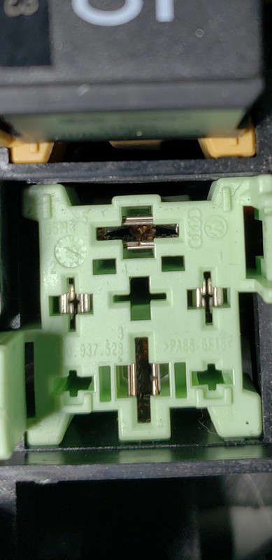

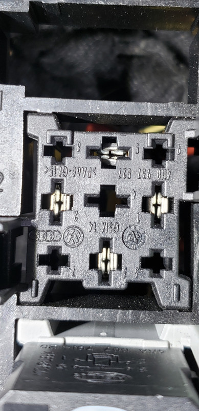

Ok So I also looked into the fuse coils. The green one is the compressor relay. Bad coils?

That's not the relay or "coils", that's just the socket that the relay sits in. I don't see anything wrong there.
