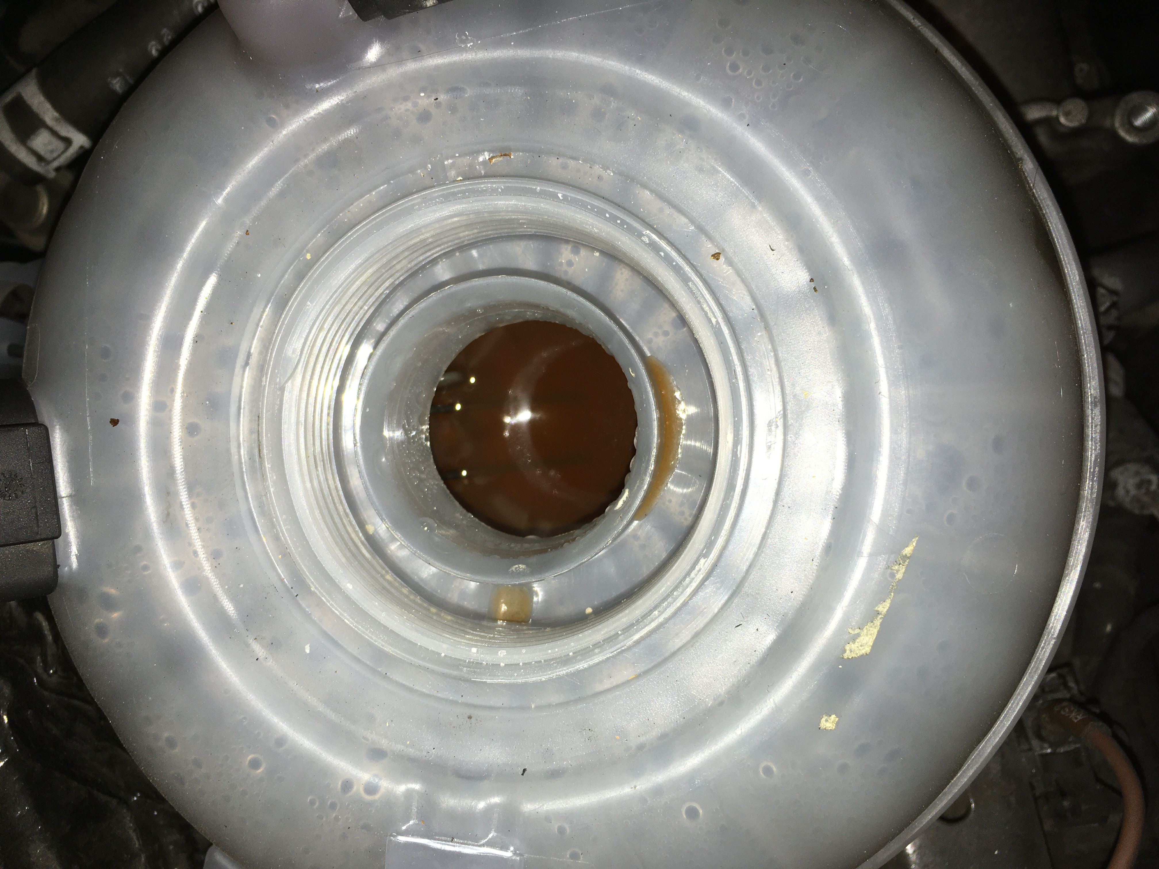

The coolant color for my GTI MK7 appears to be brown:

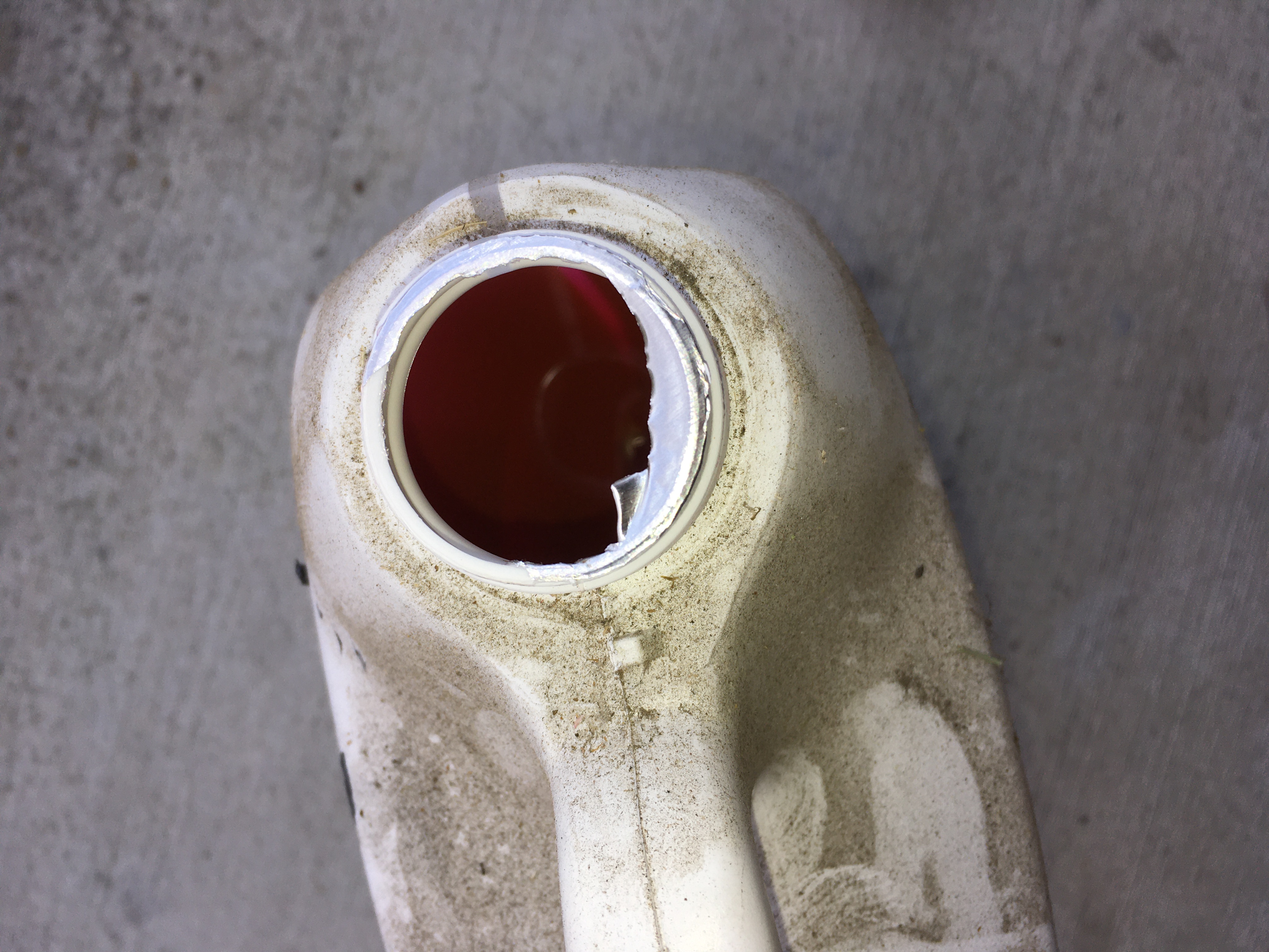

It should have been pink:
I think it's time to flush or replace with VW coolant.

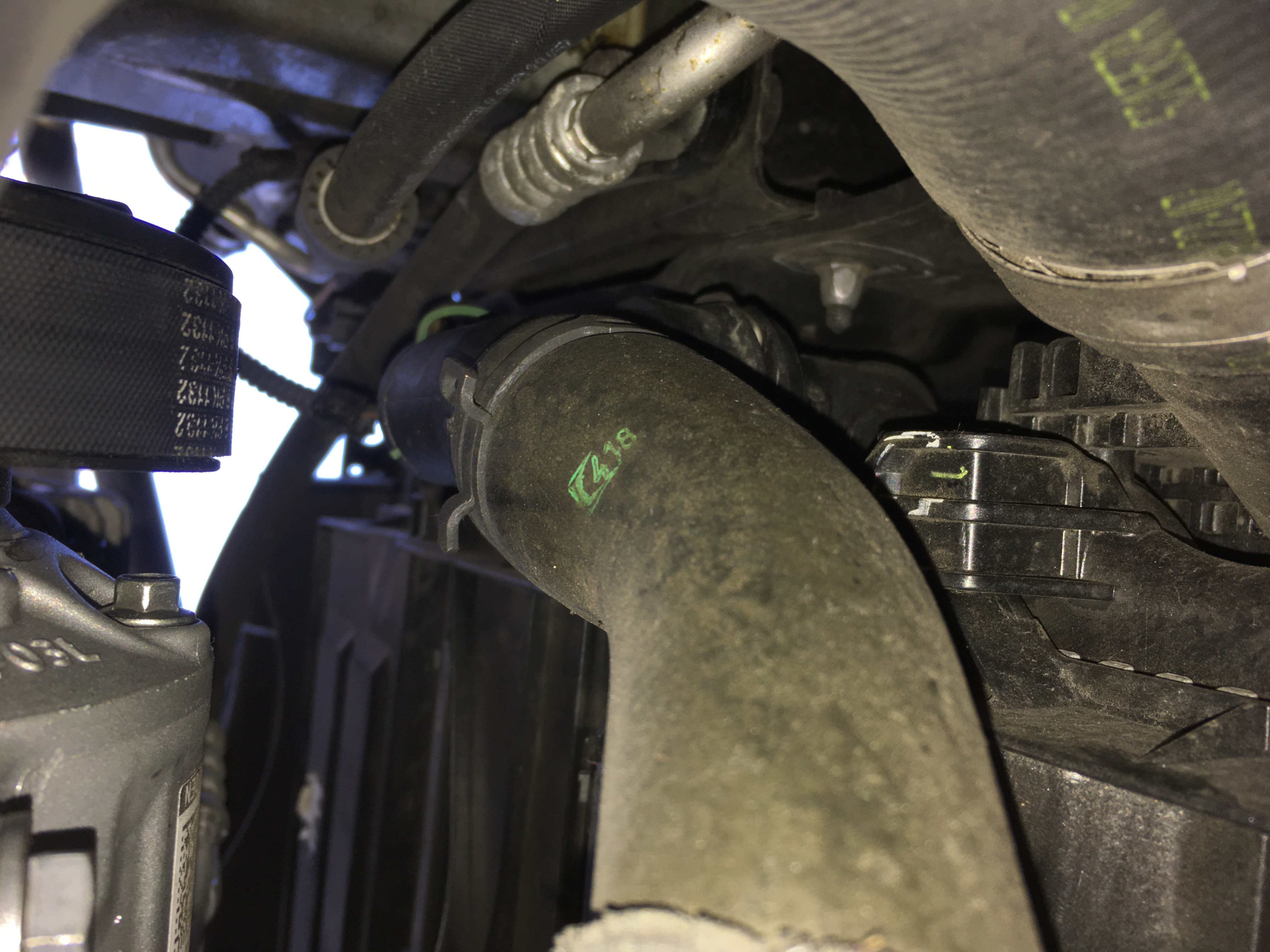

Put the car on the ramp, remove plastic splash guard, I suppose this is coolant hose that needs to be unplugged to drain old coolant?

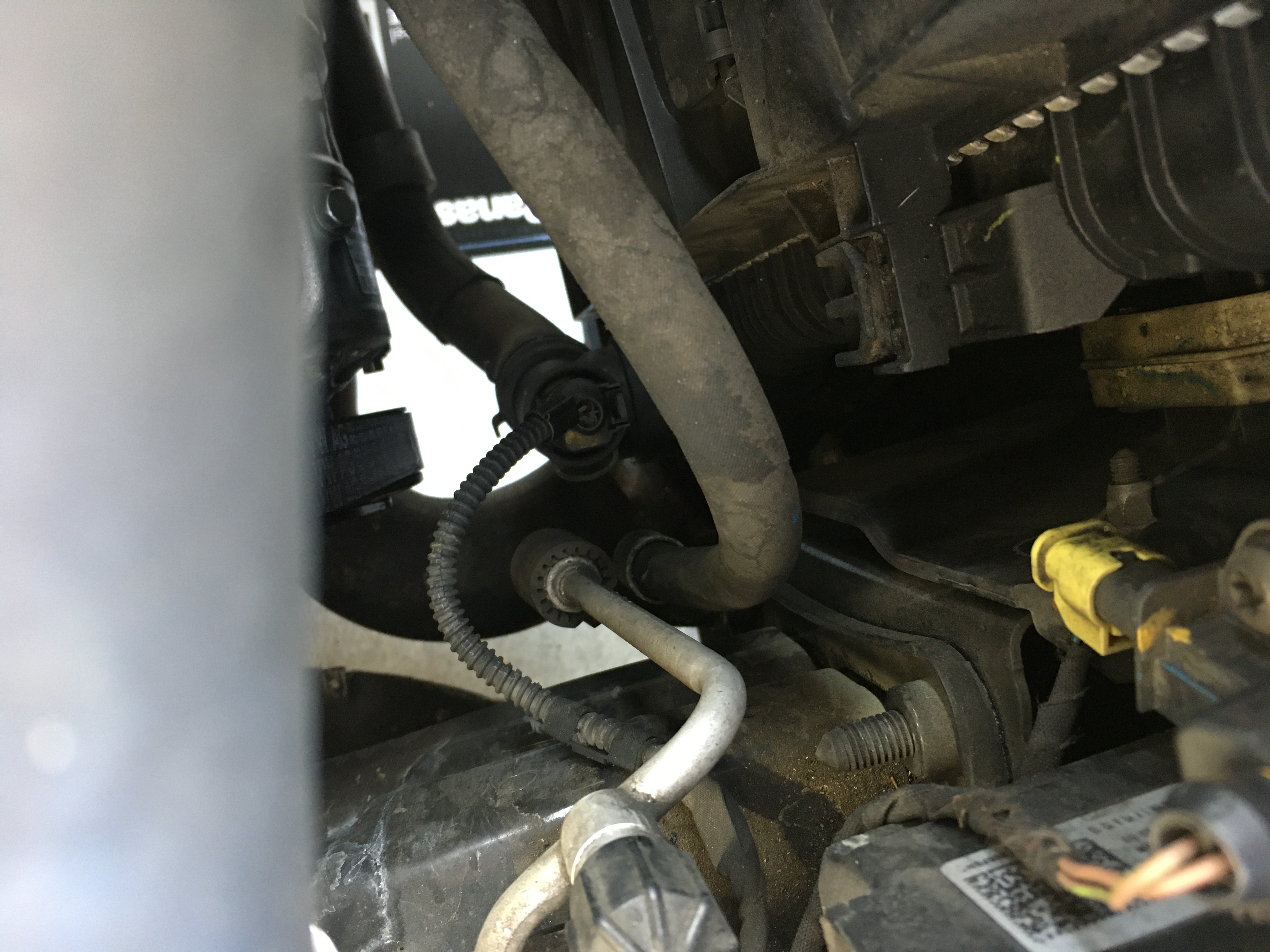

There is a electric connector on top, shall I unplug it? I see someone on Youtube unplug it, but I do not understand why.
Here is the manual reference, the connector on top is to supply power to the coolant pump (yellow)
My questions:
To drain coolant, simply unclamp the coolant hose from bottom, and disconnect coolant hose after placing catching oil pan to capture the coolant?
Do I need to unplug the electric connector from top? (Engine is off and cold)
Makes no difference to the flow of water !!
You will never (easily get all the coolant out from the crevices anyway.
You would do well to use a Coolant System Flush / Cleaner !! Dishwasher tablets or Persil works well for me !!

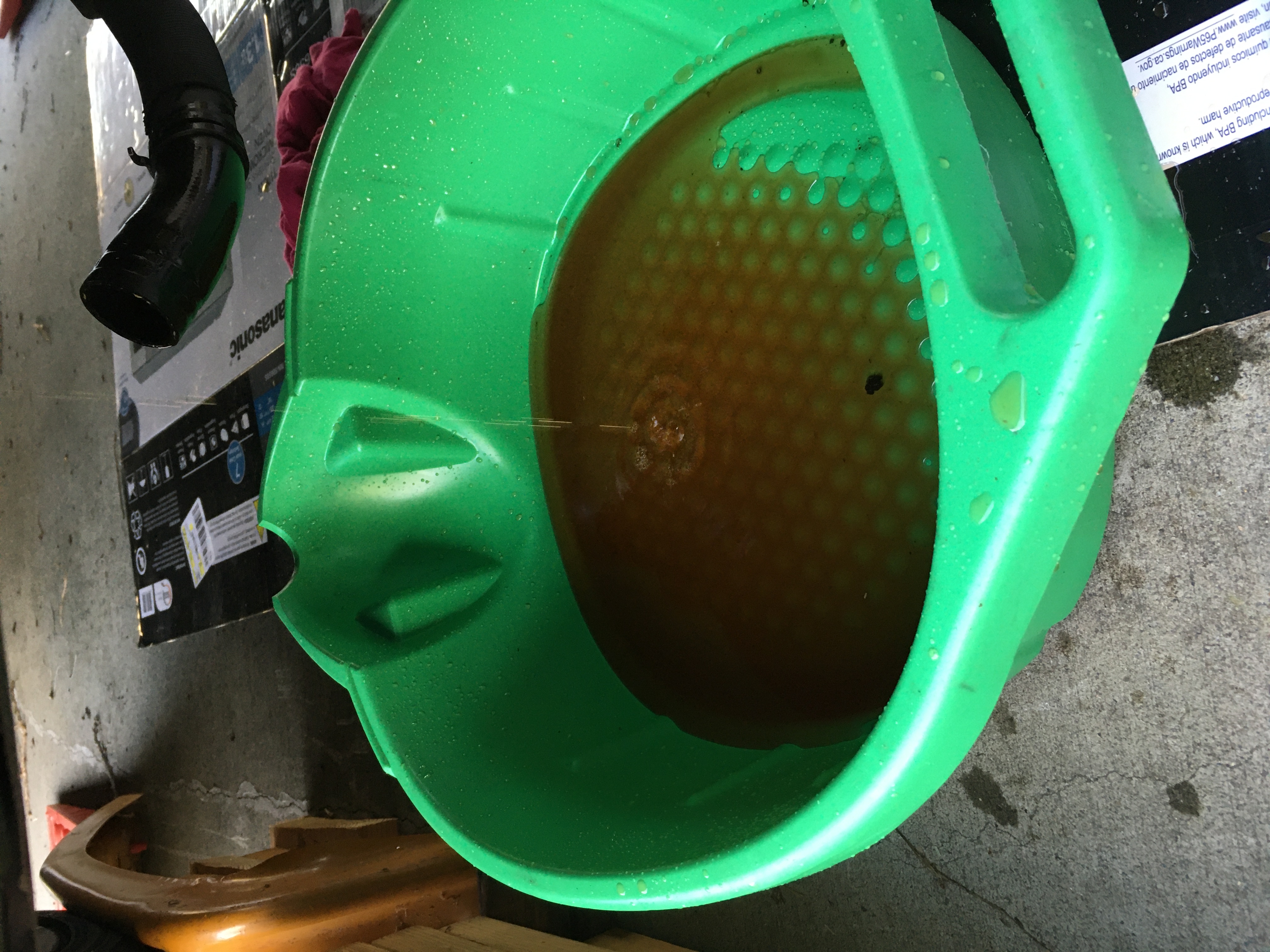

I decided to drain from bottom, had to struggle with clamp with a pair of plyers and fight with stubborn rubber coolant hose, I did not use metal tool for fear ripping the rubber hose. It needs good strength.
Finally get the hose off.
I add 2 gallons of distilled water which will displace the coolant in the system and let it keep draining.
At the end, I will add VW premixed coolant.
While it will not complete flush the old coolant, hope this will improve temperatures.
Thanks again.

Oh boy. A few thoughts. First, yes you definitely need to flush that cooling system. Not sure why it is brown, but I will share this. My 08 Passat ended up with some sort of debris in the coolant passages that found its way to the water pump impeller, locked it up, which are every single tooth off of the timing belt in a matter of seconds when I was at high RPM pretending to be a race car driver on the way to work. Upshot... engine went out of time, every piston hit every valve, and here I am today as the proud owner of a personally rebuilt, upgraded engine (the one I killed). Yes, some piece of hard debris in the coolant system got lodged between the pump housing and impeller (metal impeller). Me...I would be flushing really well. Run distilled or other recommended through the engine several times and drain AFTER basically pulling every hose I could off and cleaning etc. Debris I experience was likely piece of metal from aluminum cast head that had corroded and finally let go. That brown color you have is disturbing. I might have it chemically analyzed by a transmission shop or similar for content. Could be rust but could be many things. I don't recall what transmission fluid leaking from oil cooler looks like mixed or even oil.
Also, be sure you know what that connector is. My yellow connectors are for crash impact sensors. Want to be careful with those. Good luck

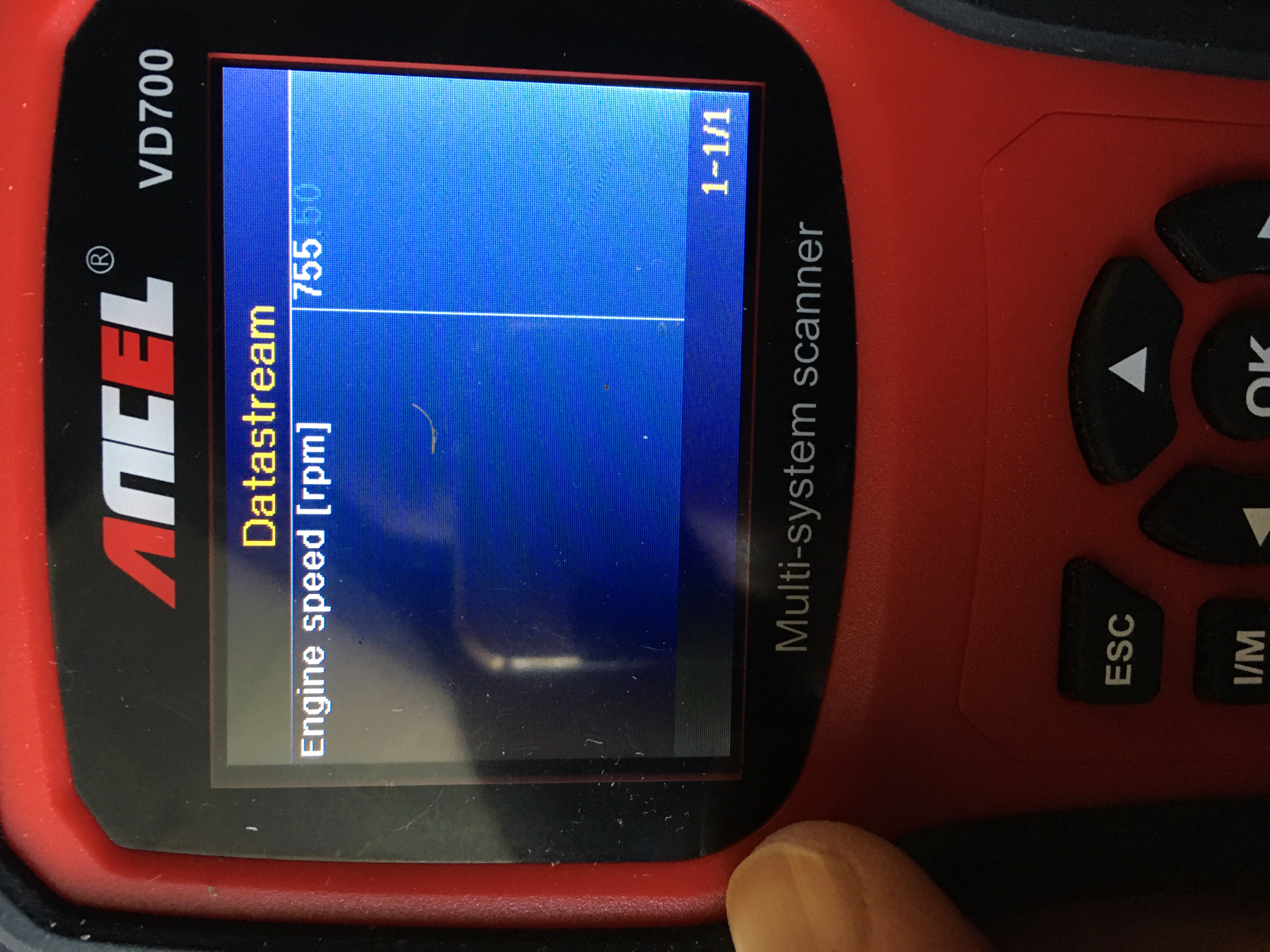

I connected a handheld OBD2 device designed for VW/Audi:
Connected this device during road test and read Datastream for all coolant temps and oil temp, saw only one short period coolant temp reached 103 C, most of the time aroung 100 c or 99 c, in a relatively hot weather during noon time on my way to Berger King, in a stop and go traffic.
I suppose temp meter on the dashboard reads from the same data source as the OBD2 device or VCDS does.
