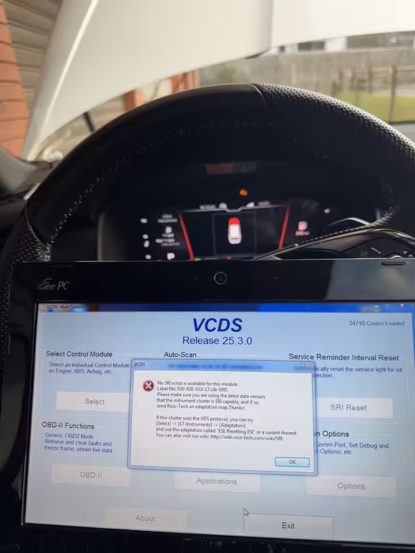

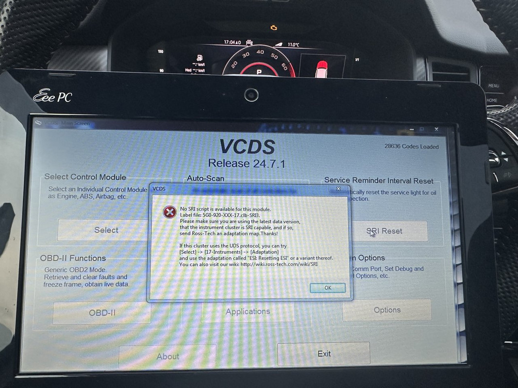

Make coding now, with bonnet open, but same error. :banghead:

I install new update with language German, but how can change languagge? Thanks :thanks:

Since your system was purchased directly from Ross-Tech in the USA, it is licensed for the standard English version of VCDS only.

Uwe, he is referring to the English labels as fallback in the updater but that will make no difference here.

Am I remembering wrong, was there not something with those Eee PC, that where slow?

Nothing of new!!!
I can hae now italian language please? @Sebastian

While we occasionally keep getting similar reports, the exact culprit is still unknown. We are investigating the issue, yet as we are unable to reproduce this, a fix may take a little longer. In the meanwhile, you can always perform the service reset manually via the (in the error message) mentioned adaptation channels.
As for the Italian version, Uwe mentioned this before but the system you are using was purchased from us in the US and is not licensed for the Italian version.
I testing another notebook (ASUS VivoBook 15 A512D) and same result :banghead:

We have not received similar reports like this recently so my advice is to firstly install this version:
Next, run this updater:
https://download.ross-tech.de/upd-beta
After doing so you will have the latest VCDS Beta 25.7.0.0 version combined with DS371.1 and Data Version 20250904 on the laptop. Those are our newest versions.
The final VCDS version step will require updating the CB in your HEX-V2 interface before testing on the car.
Please run, save and post the native plain txt Auto-Scan using that version.
If you receive the same error message when using the automated SRI Reset function please verify the Adaptation channels can be changed manually in address 17-Instruments. Those are:

As Dana mentioned, we've not gotten any similar reports recently. Based on my analysis so far, there seems to be some factor we're not able to reproduce, possibly related to the specific machine VCDS runs on, but that isn't certain at this point. I have made several attempts to reproduce this issue, both on a (similar) real car as well as a similar bench control module but either without success.
Unless we are able to reproduce this and/or see a specific indicator as to what causes this, we won't be able to provide a fix. That said, as Dana indicated you can always re-try with a newer version to see if any of the changes we make changes the outcome for you. Yes, this is trial and error but for the time being this is the best we can do. Sorry.
