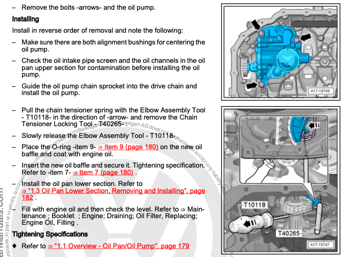

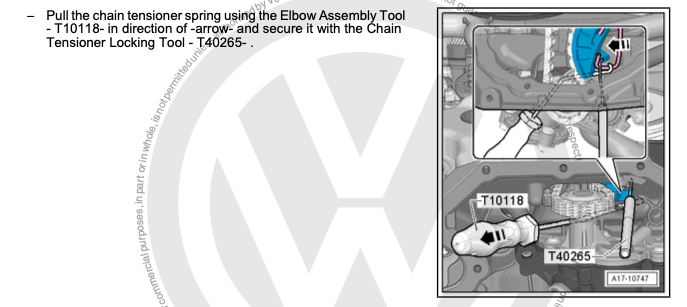

I will plan to replace the oil pump, just need to make sure if I can take it off I will be able to place it back.
I bought the tools:
T10118 Elbow Assembly Tool and T40265 Tensioner Locking Tool
I want to well plan this. There is a risk, that is I am able to remove the pump, but unable to reinstall the pump if something goes wrong. Just need to be well prepared the task.

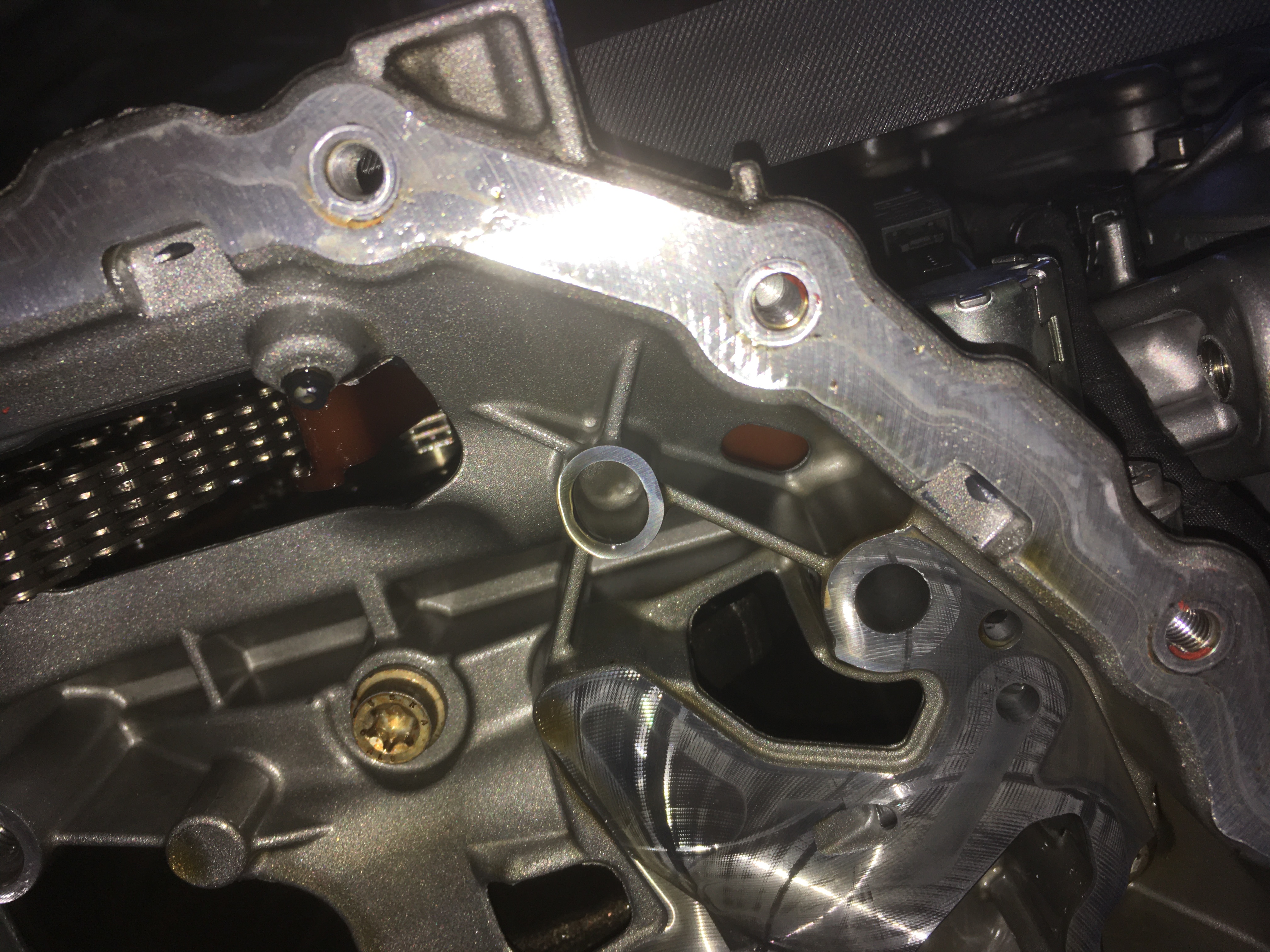

Finally I spent time to remove the oil pump from my MK7:
Some observation:
If I turn the sprocket (chain wheel) by hand, I can feel resistance and hear some sound, it is not effortless and smooth turn. Not sure if this is indicative that the pump is defective, as oil pressure with RPM such as upon starting, oil pressure is at 4 bar, oil pressure drops to 0.8 or 0.7 bar during hot idle even with 20w60 oil. I will intend to buy a new oil pump anyway, given the effort spent to remove this oil pump.
Mu understanding is that there are 2 gears inside the oil pump, 1 gear is on the same axle of the sprocket, which is driven by the chain. That gear drives the 2nd gear that is pushing out oil, generating oil pressure. Such a simple structure (far simpler than a clock), how can an oil pump fail within 70k+ miles usage?
Should turning the sprocket be effortless, smooth and quiet with a good oil pump? I suppose the resistance would reduce the rotational force to push out the oil... I might open the oil pump to see the internal.
Thanks
