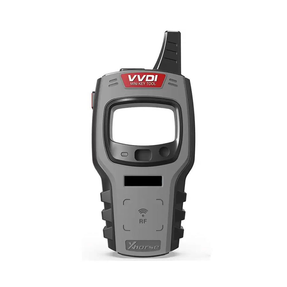

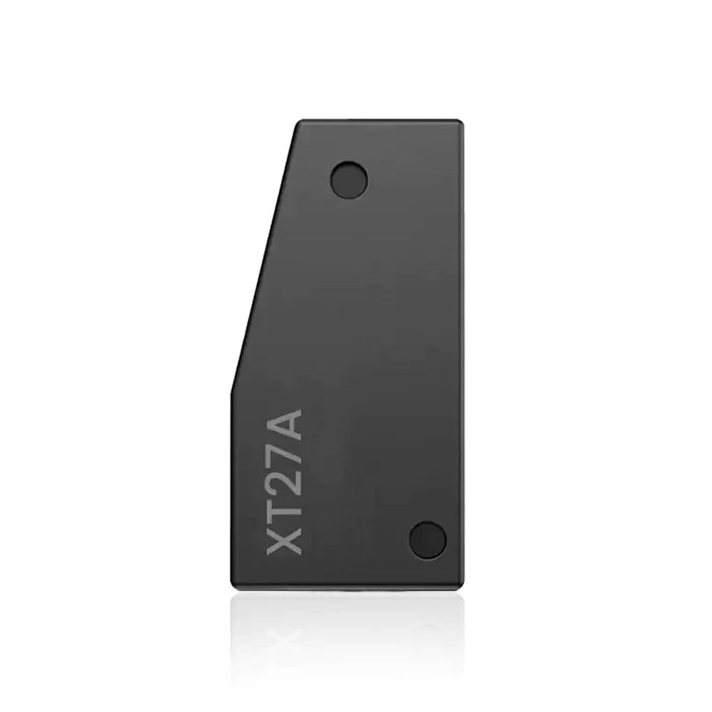

I used an Xhorse Mini Key Tool and their Superchip,
