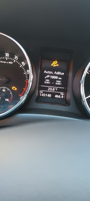

Pour AdBlue into the tank for him.
Connect with the control unit 01 - engine
04 - Basic settings
Select item in menu: IDE04730 - reset - Use the SCR system to block the starter - AD-Blue

Thanks for your contribution, but I think I explained myself badly: I would like to eliminate the display of this data in the MFA, I would prefer it not to be displayable at all.
