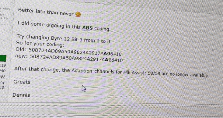

Does anyone know how to turn hill assist off , transporter t5.1 manual

does anyone know how to turn hill assist off , transporter t5.1 manual , l cant stand it

Has it got an Auto-Hold button? If yes, then this turns it off

It's not the handbrake it's built into abs there's no buttons

sorted it , find this post and it worked

Yea my drive is steep and if you want to edge forward
A Little it locked and doesn't feel right , feels like a normal
Van now with it off

this is my new coding
will look in adaptions tomorrow
508724AD89A50A9524A49179A96710
508724AD89A50A9524A49179A16710 new
l didn't see any options like the t6 has
