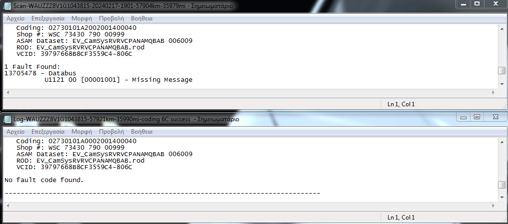

Hello to all, the problem was solved by intervention of the manufacturer.
In particular, he forwarded to my email the dataset that he reconfigured in 6C.
The process was done with odis e and after 20-25 seconds, various sounds were heard from the car's units.
Cleared errors except for 6C and 5F, because the camera encoding was zeroed.
After coding magically all the errors disappeared, and the diagnostic protocol took the form below.

Address 6C: Back-up Cam. (J772)       Labels:| 5Q0-980-556.clb
   Part No SW: 5Q0 980 556 B    HW: 4M0 980 556 A
   Component: RVC Compact   H19 0231
   Dataset Number: 8V0909460E  0005
   Coding: 02730101A0002001400040
   Shop #: WSC 73430 790 00999
   ASAM Dataset: EV_CamSysRVRVCPANAMQBAB 006009
   ROD: EV_CamSysRVRVCPANAMQBAB.rod
   VCID: 39797668B8CF3559C4-806C

Also something I should add is that the success of the project was successfully completed thanks to the change of encoding to byte 4 .
Specifically, the value changes from A2 to A0.
This code change was successfully made using old generation hex-net vcds.
