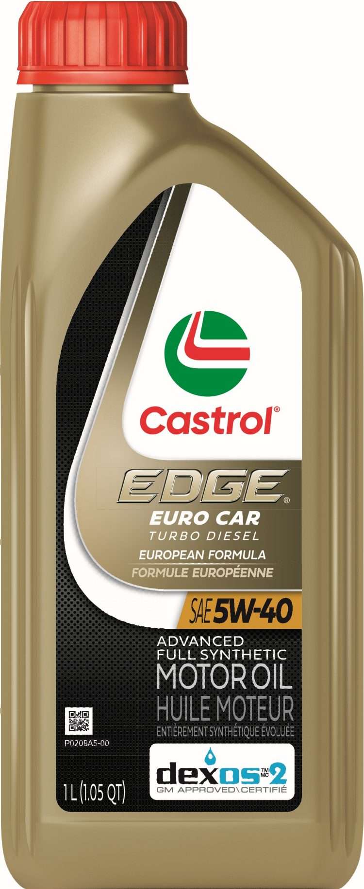

Are you using Castrol EDGE Euro 5W-40? I find that oil particularly high in zinc tend to do a better job of dealing with heat and friction inside the engine. I recentely put a somewhat new engine (has 10k miles on it) into a 2014 a4 thats my currently daily driver for testing. Currently running 5w40 delvac mobil1 oil.
Oils in Europe are not always the same as here, and even when they are, they'll usually have different names.

I was using this one -> https://www.castrol.com/de_de/germa...oils/castrol-edge.html#tab_turbo-diesel-5w-40
Accordingly to data sheet it should be the same as this one in USA
