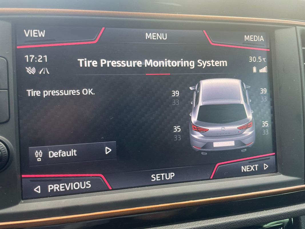

Hi All,
One year ago I installed retrofit TMPS module (5Q0907273B) with sensors (coding) and everything working fine.

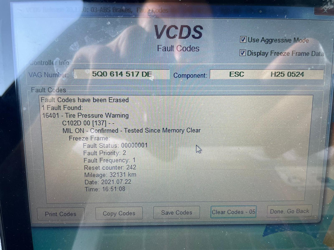

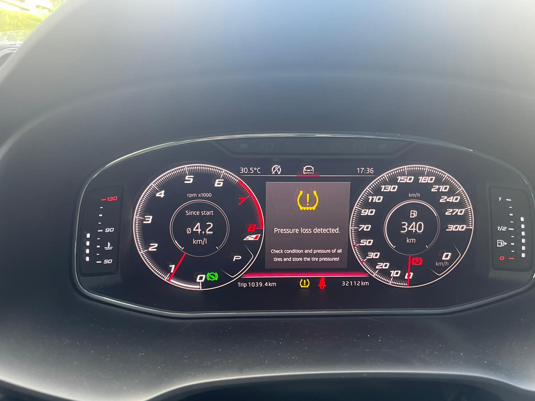

one week ago i changed to new tires and come the issue in ABS model C102D 00 [137] that i cant erase but all the sensors are working good
Please assist how solve this error it some like some old bit with storing the tiers pressure is active and when i changing from full load to comfort or default nothing is changing
see attached photo
thank all

Please post a complete Auto-Scan for context, so people can see how the car is equipped and configured.
Have the wheels been fitted in the same places, especially front/rear? If not and the front & rear tire pressures are different the TPMS will be thinking that a tire pressure is wrong because the wheel sensor is in a different place.

Have the wheels been fitted in the same places, especially front/rear? If not and the front & rear tire pressures are different the TPMS will be thinking that a tire pressure is wrnog because the wheel sensor is in a different place.
HI yes,
first time we move rear to front and rear new set.
after two days we change back to previous position but still the error code cant be erased
