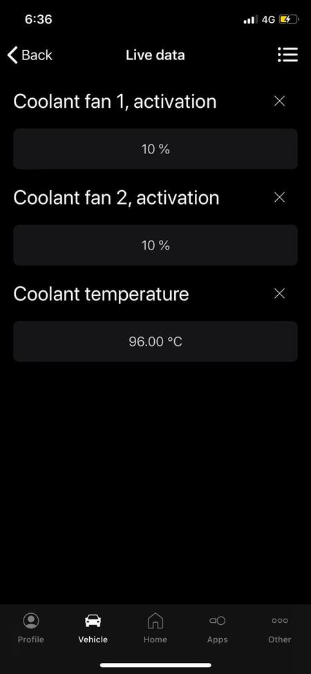

As per the title - my radiator cooling fans dont work as they should and I cant figure out why. Generally speaking whenever the AC is off, the fans dont spin at all, and I have see the temperatures rise and rise. It has on an occasion led to damage - new Gearbox oil cooler, and even caused a blown head gasket due to overheating. I used VCDS - No codes related to anything about cooling or fans etc
I used OBDEleven and noticed temps hitting 100 and still the fans were not spinning more than 10% speed. The screenshots are attached.
AC Off and at 96'C only one fan runs fairly slow
AC Off and at 99'C only one fan runs fairly slow also, I know from experience it will only climb up to 100+ and the fans wont kick in

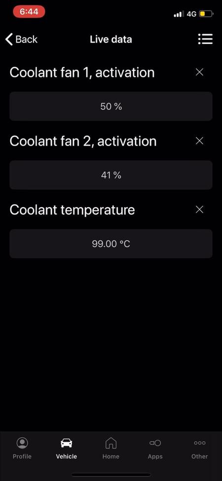

A/C On - both fans run at medium speed - provided some cooling and temps started lowering...
The weird thing is, despite the fan activation above, When the A/C is switched off, only one fan spins and that too at slow speed. However when the AC is on, they spin at around 40-50% speed.
I then ran an output test on the fans, and they ramped up to 100% speed - this was a surprise to me as I have never seen them work so fast.
So I am now confused as I thought the issue was with my Cooling fan control modules, but in the output test they worked... Could it be something else?
