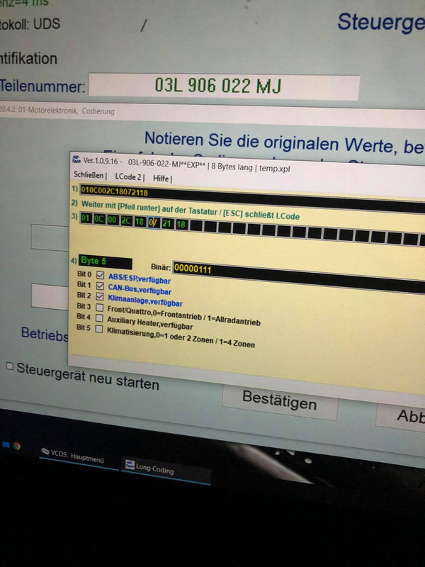

I'm doing an Audi 8K FWD to AWD conversion.
The work is done, only there is a problem with the engine control unit. There is a different gear ratio in the transmission, so the cruise control does not work properly.
There is an option in the engine control unit to select AWD but not accept it. what is the solution ? ECU replacement only?

Check the parts catalog (dealer, ETKA, PL24). If this ECU (03L-906-022-MJ) was only used in FWD applications, then you will have to replace it with the correct one for the application, or have it flashed with software for AWD. Cruise control is also quite fussy about transmission ratios; it will compare engine speed and vehicle speed in the current gear and won't work if the ratio isn't correct.

Thanks for the reply. Yes the current ecu only exists in FWD. I'm buying an AWD ecu, that's not a problem, I just don't know if the Audi dealer can do the coding or not. According to the chassis number, this car is an FWD and that is always a problem.

I have a new idea. I found flash files. Can i try to flash? VCP or ODIS Engineering maybe? Not a big risk?

I am happy to share with you that everything is okay :). Everything is fine after flashing ODIS-E. Cruise control works as it should :). Thanks for the help .
