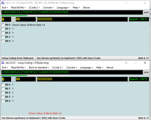

Hi Nils,
i'm sorry, but it seems like the latest fix/workaround greates a new glitch :cry:
If i additionally insert a pull down menu in byte 6, the glitch is gone.
Above the new version with the glitch at bit 0 line, below the previos version w/o this glitch

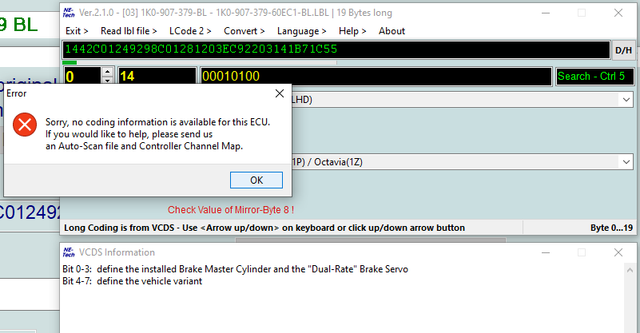

Hi Nils,
the previous glitches seems to be fixed,
but since version 2.1.0 it's not possible to load a different lable, if LCode is started in VCDS. If i start only LCode, the loading of a lable is no problem.
