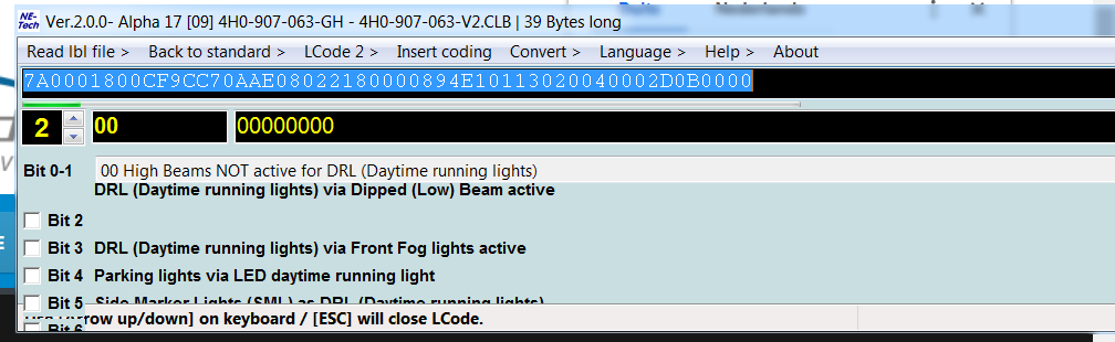

Alpha 12 (@ #1)
Should be able to click on the long coding.
Changed Alt F1 (About).

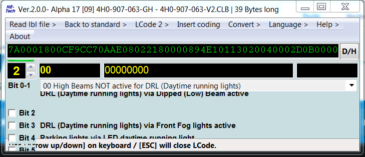

With a small notebook, 13/14inch and FullHD we encounter a scaling problem with the long coding helper and the windows scaling on 125%
Can you implement a scrollbar or make the helperwindow resizable?

Try if there is an difference:
Alpha 18 (@ #1)
{Changed scaling setting}
{Puldown menu text bold}

thx, i will try that, i'll report back if it worked or not.
   #30
Vdub
Dec 18, 2016
971
596
C?ID=57533
it works better now, cannot say that the dropdownlist of the bytes is an improvement but it looks better now
