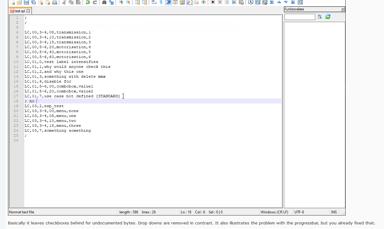

First, I cannot change color for single bytes in the long coding edit box.
Can you (or other) tell me why it is really necessary to know, where you are at the long Byte string?
Does that give any extra information?
Yes we have been used to it with the old version, but that takes a lot of space, to show all Bytes separately.
There is the currently shown Byte number, the current Byte value and the current Byte Value in Binary, that is important
It's probably not. We are just used to it.
Of course I can elaborate on #3. This GIF should display, what is meant:
Basically it leaves checkboxes behind for undocumented bytes. Drop downs are removed in contrast. It also illustrates the problem with the progressbar, but you already fixed that.
I also noticed #6: Preference for XPL over LBL as default type is not yet saved in LCode.ini. Not sure if it should, but I would like it.
As for the searching: I have not yet found a way to go to the next byte, where my search text is found. Could you please advise.

Can you please post the xpl file here, I cannot stop the gif it just fast.
