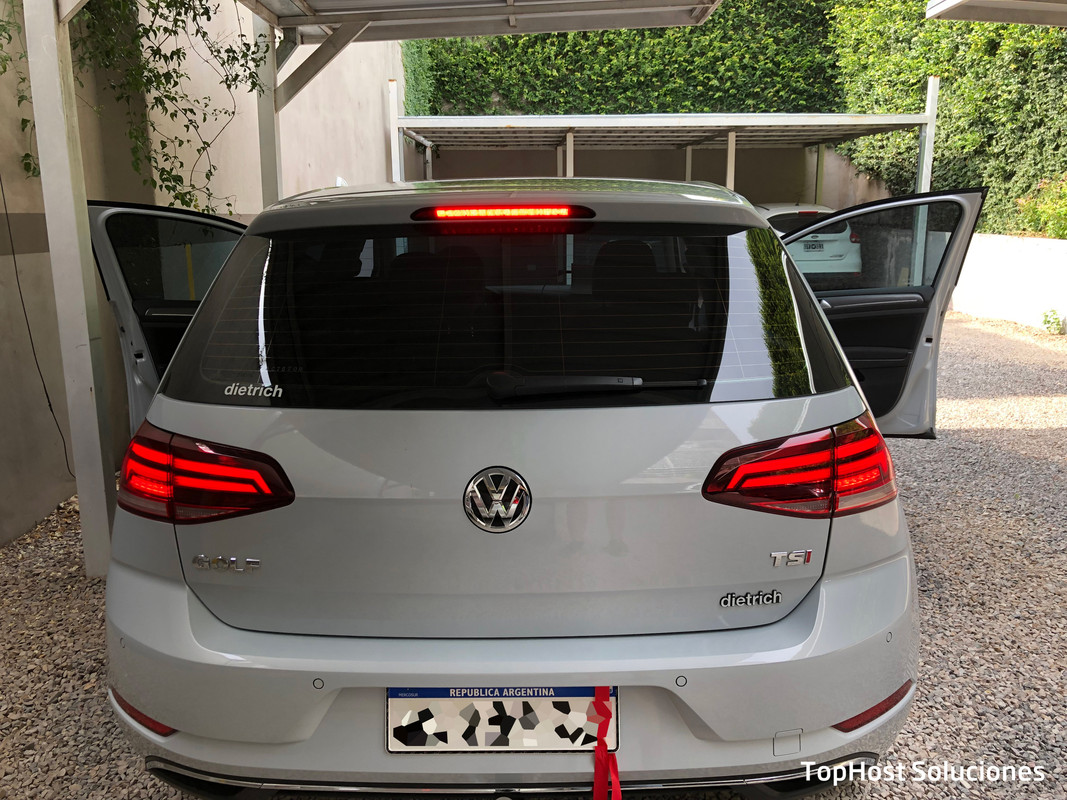

Hi,
Today I did some coding on a Golf MK7.5 and tried to figure out how to code the tail lights to enable 5-brake lights mod, without success. I'm starting to think that maybe there is no chance to use the inner tail lights as brake lights, but maybe you can give me some advise.
The outer tails are Leuchte23SL HLC10 (left outer) and Leuchte24SL HRA65 (right outer), but don't know how to code the inner lights to work as both parking and brake lights.
The following images describes the factory settings
Lights Switch: AUTO/POSITION/LOW-BEAM/HIGH-BEAM
Lights Switch: 0 // Brake Pedal: ON
Lights Switch: AUTO/POSITION/LOW-BEAM/HIGH-BEAM // Brake Pedal: ON

Today I had some time playing around with this mod.
I've found the following facts for this MK7.5 tails:
Leuchte20BR LA71: Outer Left-Side Brake Light (this lights are placed below the position/parking lights)
Leuchte21BR RC8: Outer Right-Side Brake Light (this lights are placed below the position/parking lights)
Leuchte23SL HLC10: Outer Left-Side Position/Parking light
Leuchte24SL HRA65: Outer Right-Side Position/Parking light
Leuchte17TFL R BLK SRB3TFL R BLK SR KC3: Inner Left-Side Position/Parking light (those placed on the boot)
Leuchte16BLK SLB35BLK SL KC9: Inner Right-Side Position/Parking light (those placed on the boot)
So, I did the following changes over the factory settings:
Now the issue is that the position/parking lights don't look like they are capable of decrease or increase the brightness. I've tried Dimmwert values of 31, 86, 101 and 127, and all look the same. I realize that I didn't tried with a lower value (i.e., 10). Maybe VW did some savings on those LED lamps.
Finally, the results are closer to what I wanted at the beginning: a 7-led brake light mod (now only works when the light switch is on 0).

This mod (currently) only works when lights switch is on "0". If I select other (parking, low-beam), then the parking/position lights turn on at full brightness (as I stated before).
The only value I didn't try is Dimmwert 10 for position/parking lights (31, 86, 110 didn't show difference with 127). Will try in another car (same spec) in some weeks.
-- EDIT --
Sorry, I've read your post again and now understand what you were asking.
I didn't try that scenario (auto lights when lights off -- i.e.: during daylight), but I think this mod will work on that scenario.
littlejoe
Feb 25, 2019
C?ID=361262
-- EDIT --
Thanks for the update. I going to try this on my 2019 NA GTI as well and report back the results.
