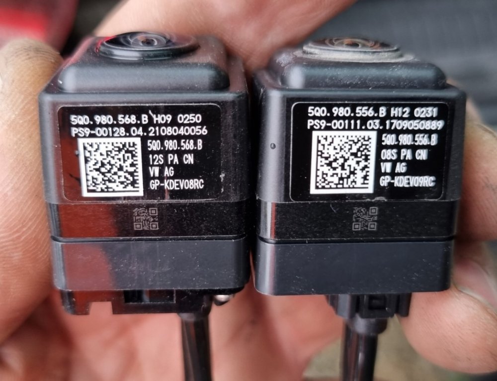

Hi - I'm relatively new with VCDS but have successfully coded bits and bobs before on my T5 and T6 and am moderately IT literate - I'm trying to enable trailer assist on my 2018 Tiguan R-Line. From what I can see, I have all the necessary components (swivelling towbar, park assist PLA 3.0 & RVC Compact H12 0231 backup cam). I can code the instrument unit (12:5) and the park assist module (0:3) but when I try to save the coding for the camera (10:3), I get an Error 31: Request out of range when hitting "Do It!". Does this suggest the camera is not capable? It has the lines that move with the steering etc and I thought would be OK?
Camera Image
Also, the Park Assist throws an error when done but I'm guessing I just need to ignore that and clear and it will then be OK?

Robert Z
Sep 18, 2019
58
106
Ireland & Poland
C?ID=423656
You need a Compact + camera.
See below.
The one on the right in the photo above has NO TRAILER ASSIST support.
The one on the left supports TRAILER ASSIST.

Many thanks for the replies. Is the replacement plug and play or does it require coding? Also, where do I get one?

What about the 360 area view system?
That has suitable camera for trailer assist. So yes, only coding.
Yes, camera needs car specific dataset and coding and calibration. Try ebay, official parts shop, allegro, add breaker here :)
Thank you! Still looking for one!
