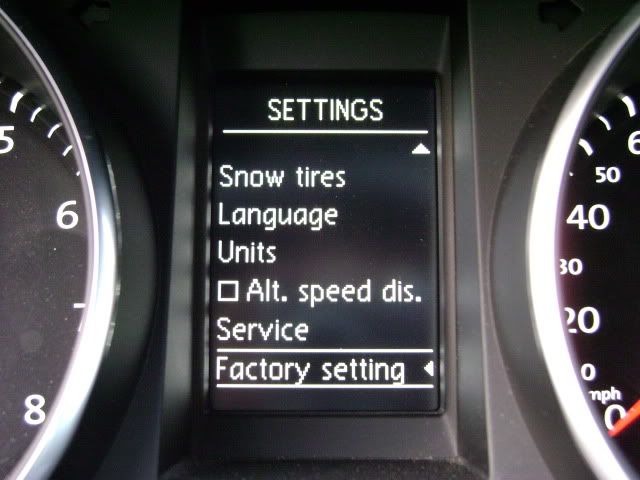

I suspect you have Alt. speed dis.(play) enabled, which will show the speed in alternative units like this 2010 NAR Gti cluster:
This RoW 3C cluster shows alternative miles when enabled:
