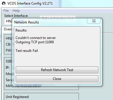

Click: [File] -> [Network Test]

C?ID=512383
not work:

@widi, try another USB on PC or reboot PC & router, please.
another USB on PC: not work
reboot PC and router: not work
reboot PC and internet from mobile phone: not work

In that case, since I can't configure the ports, I would go to a neighbor or colleague where the update has been tested successfully. Maybe I would send it to a local VCDS distributor for an update.
Sorry, I have no better idea.

OK, I see a problem with one (of the four) server instances.
Will try to get someone over there to give the server a whack on its side. This may take a bit, given that it's Easter Sunday...

Yes, it works, thank you!
I didn't have the fault, it worked well until yesterday. It didn't work this morning, I didn't do anything (I didn't configure TCP, UDP, firewall, etc.), now it's working again.
