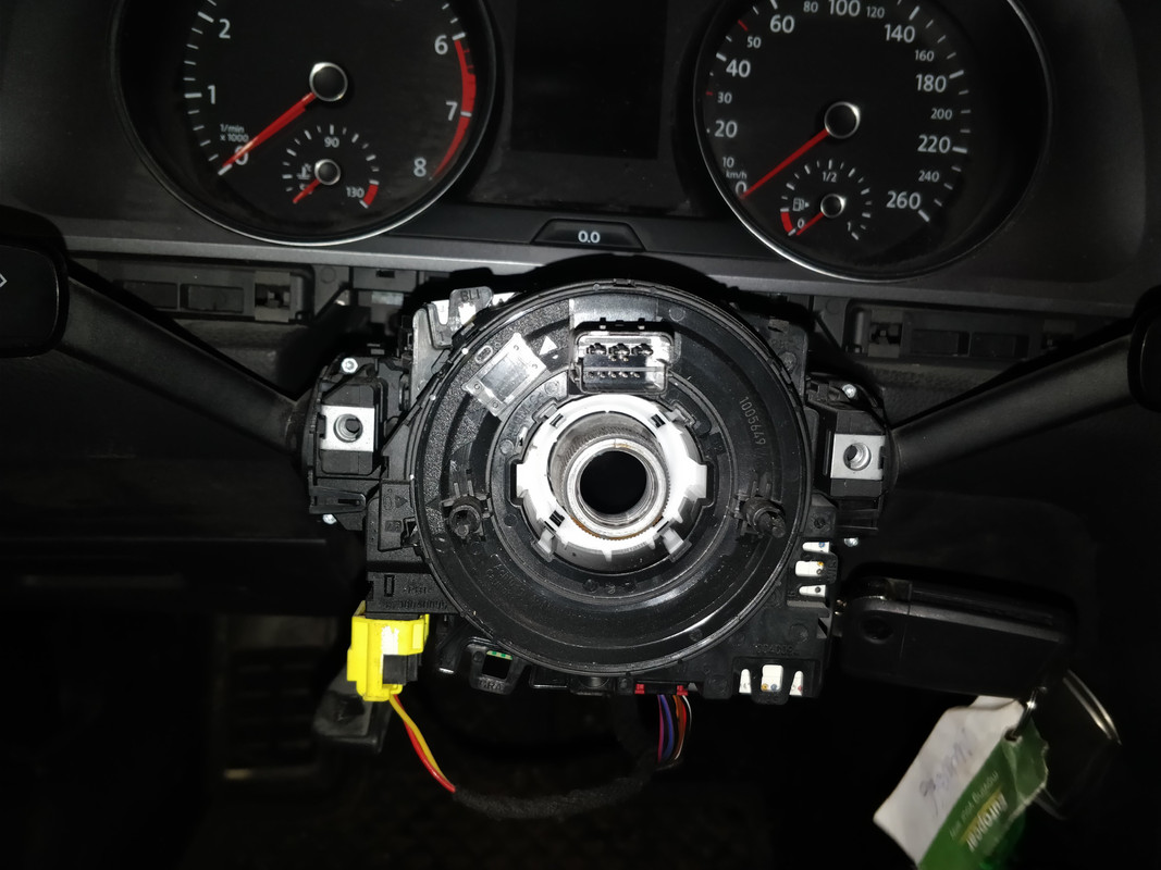

This is not DIY, this is a guideline. This guide describes CCS for Stalk based cruise, not MFSW based.

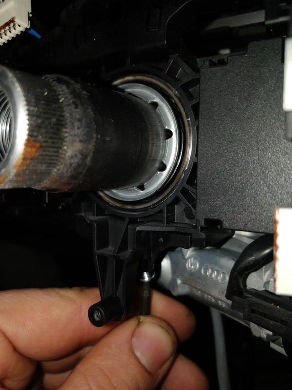

1) Remove steering wheel and stalks.
2) Replace stalks with new one.
3) Replace Accelarator pedal
4) Check for CCS wire in pin5 of SWCM.
5) If not available use the wire in kit and run to ECU.
6) Assemble everything.

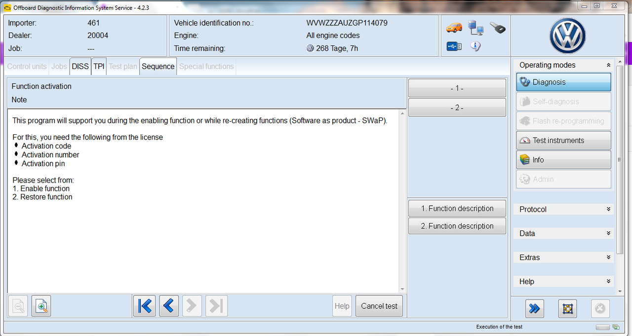

7) Start up ODIS
8) Make the login and basic identification
9) Use the FEC Clearing option in special functions. Select Function Enable.
10) Insert all needed stuff from paper from Cruise Kit
11) Follow ODIS commands. It will add FEC and update coding in 19, 16 and 01, in this order.
